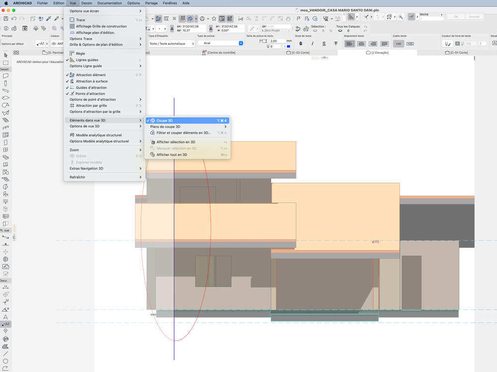

You just activate 3D cutting and there's a cutting plane (see attatch).
Deactivate 3D cutting.

Hey  Bruno, thanks for your answer. I´d alread deactivated the 3D cutting, everything  seems to work properly.
