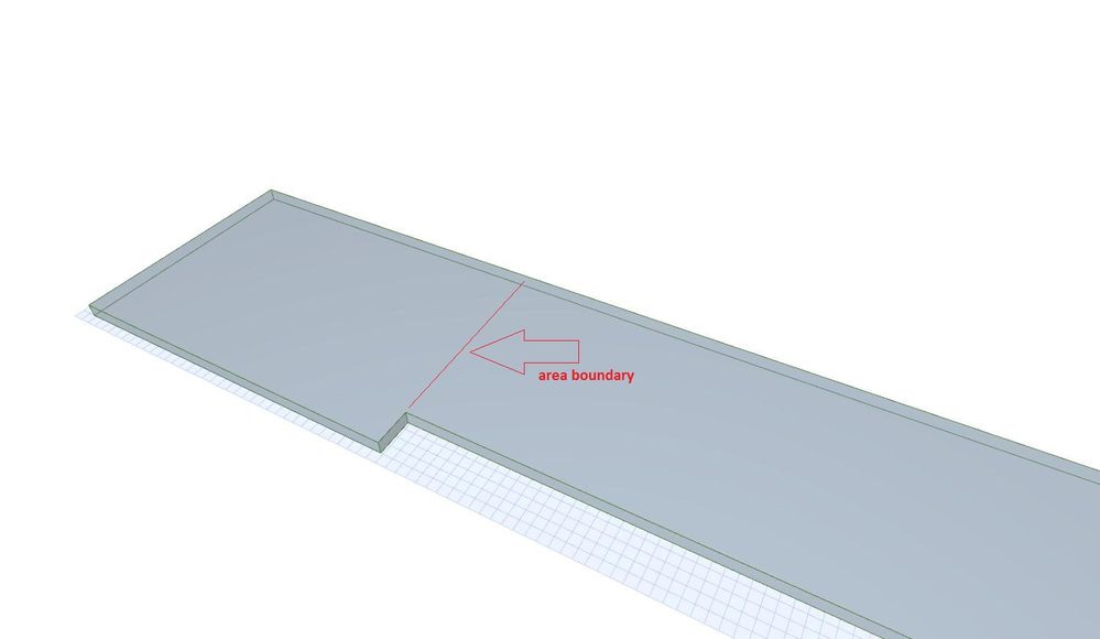

Hello I have a query about zones in 3D.
Is that possible to set boundary in 3D for zones. Now on the picture you can see two 3D zones with Glass material. Unfortunately this looks like one object basiclly it is two. I tried OpenGL and Internal setting but I could not find anything.
I intend to do a simple box illustration of function areas. Should I use Slabs for this purpose?
thx in advance.

andras:
If you want the material to have the same appearance for all Zones, but have a line between Zones, then Duplicate the Material and use the duplicate for one of the Zones, this will show the line between Zones.
