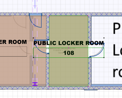

How do I CENTER stack text as in the name PUBLIC LOCKER ROOM
PUBLIC
LOCKER
ROOM

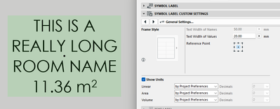

You have to turn on Text Wrapping, then set the max width of the text box... The width is scale sensitive... You can disable this scaling if you edit the start of the objects 2D script.

There is NO Wrap Text in the Zone selection

And it also does not let me drop the borders around the labels and I cannot easily select the boxes to edit.

It looks to me like you are using a zone stamp and Ling has shown you a zone label.
There may not be a 'width' value in a zone stamp but there may be a 'number of characters per line' value in the parameters.
But that may depend on the stamp you are using, they all have different settings.

That would explain the missing text settings.
You can force the width of the stamp in the same way. By default the option is unchecked and the width matches that of your zone name.
