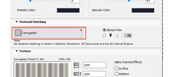

Ive made a copy of an existing surface and only changed the colour. The attachment is a copy of corrugated sheet matte

Change the Corrugated vectorial hatching to Empty Fill. It is this fill that is is adding the extra lines. Not necessary when the corrugations are modelled.

Thankyou
that worked
