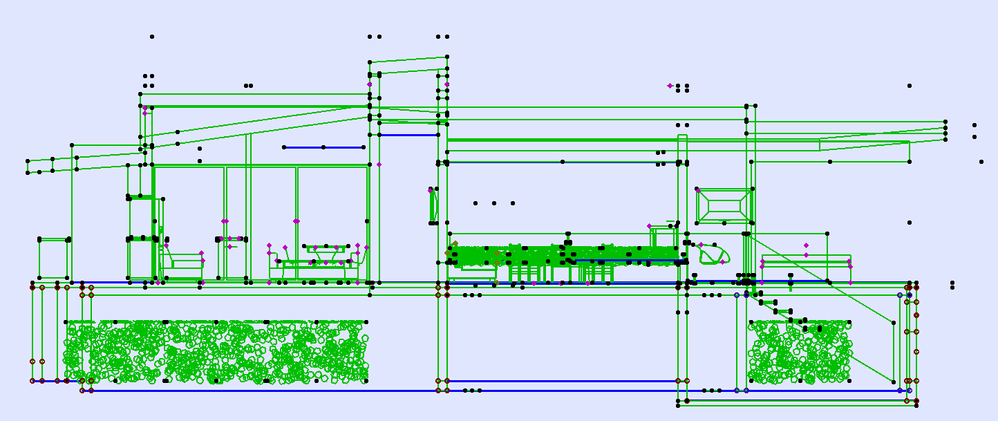

I just tried it out, went to axonometric view (o.k. so far), View> 3D Navigation Extras> Look to perpendicular of clicked surface, and my model, too, has disappeared (image below with elements selected). Going back to perspective view does not help. Rebuild does not help. Going to a saved 3D view does not help. Looks like a BIG problem.
