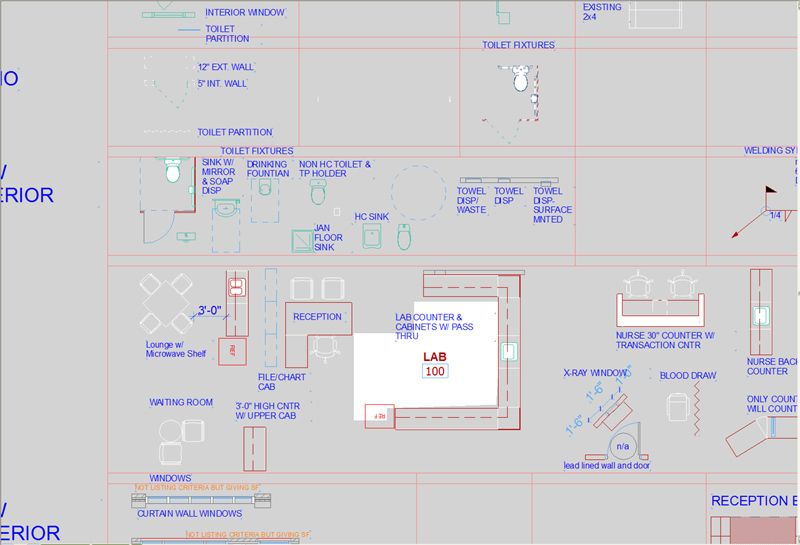

I am having a very strange issue with AC10. I've imported my pens from our AC9 template in our AC10 template (I'm not sure if this is the source of the problem). Now I have a file where some of the lines are changing pen colors while I zoom or pan. Some lines display white. The interesting thing is that they do not change the pen in the objects settings - they are what I originally set them as - they are just displaying all weird.
Furthermore, when I open our template for AC10 it all appears just fine. But when a fellow employee of mine opens theirs, it gets all weird like this. I was wondering if anyone is having the same issues.
The first image shows what part of the lines look like when I am panning. The second image shows what the same area looks like when I am not panning or scrolling.

I had this issue when I first installed AC10.
I updated my video drivers and all seems well now.
