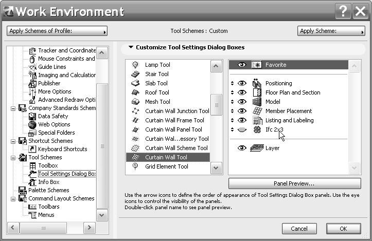

For anyone not interested in exporting or synchronizing the IFC model...
You can stop the window from 'super-sizing' by turning off the IFC 2x3 attributes in the tool settings dialogue in work environment...
