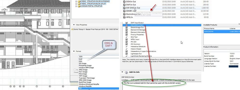

Hi All,
I have a related problem with the add-ons at the DXF-DWG-Out In the picture I attach to explain that the add-ons are out of date so I will not be able to export some images for use in structures that are needed by other parties with a DWG extension.
ArchiCAD build number 3259 I hold updated without any problems.
Please help a solution.
Thanks

A standard add-on such as that should never be 'out of date', as the hotfix updater updates the add-on along with the program. It is possible that they were moved or renamed from their standard positions/names at some point.
Standard add-ons are not available for separate download, so your only option is to uninstall and reinstall AC, then re-apply the latest hotfix.

Hi Karl,
Hi Karl
Thanks for the advice of his, reinstall does not give change to convert DWG still not available in the options menu in the publisher.
I've tried to reinstall with the findings that this problem only occurs when updates take place from 3235 to 3259 Build Number due to the build number 3000 and 3235 did not occur this problem.
I tried backing up the add-on 3000 and 3235 DXF-DWG special In-Out and overwrite to build 3259 as well as on the actual conditions can not provide a solution to convert DWG files.
Does this problem does not occur in some people who walked with ArchiCAD 64 Bit, if not why this is so even though the update process runs without any problems.
Is this is a problem with the update build number 3259?
I beg help for this problem is urgent because of the time there are several DWG files that are needed by my team structures across town to settle and draw results from their analysis.
