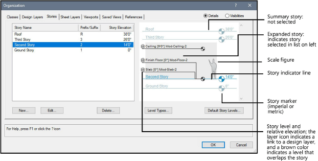

Vectorworks has something like that, that could be quite useful. For Finished Floor Level, Ceiling level for fixtures.
