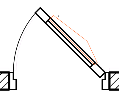

Hi ! Any chance to make those lines thinner ( image 1) ? This is symbolic view of a door, and also for windows.

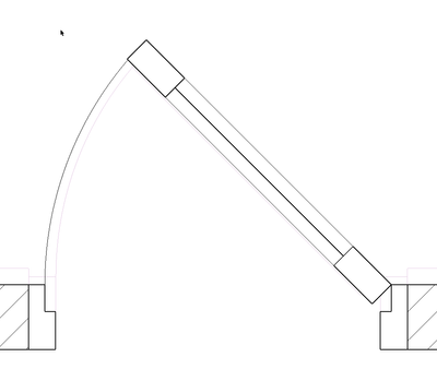

I really do preffer the image 2 representation which is achievable by toggling that icon kosta_2-1646218894031.png
as it cuts only those frame lines that are really under cut.
image 1
 image 2

I want to change the thickness of that one line

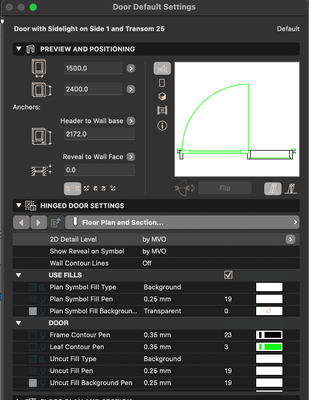

You probably need to either change the 2D representation pen settings in your door/window object or review the Pen Set assigned to that View in the View Map. Never been a fan of the Pen Sets, but that's a lengthy topic which has been discussed several times before.

@DGSketcher I really can't find that settings , can you please demonstrate where are those pen settings are ? to make drawing look like "bold cut lines" are toggled on, at least for doors and windows.
DGSketcher
Legend
As I mentioned above, Pen settings can be lengthy topic and there are many options, recommendations & outcomes depending on what you do. Sometimes you just have to try things until you find what works for you. Hope the image helps.

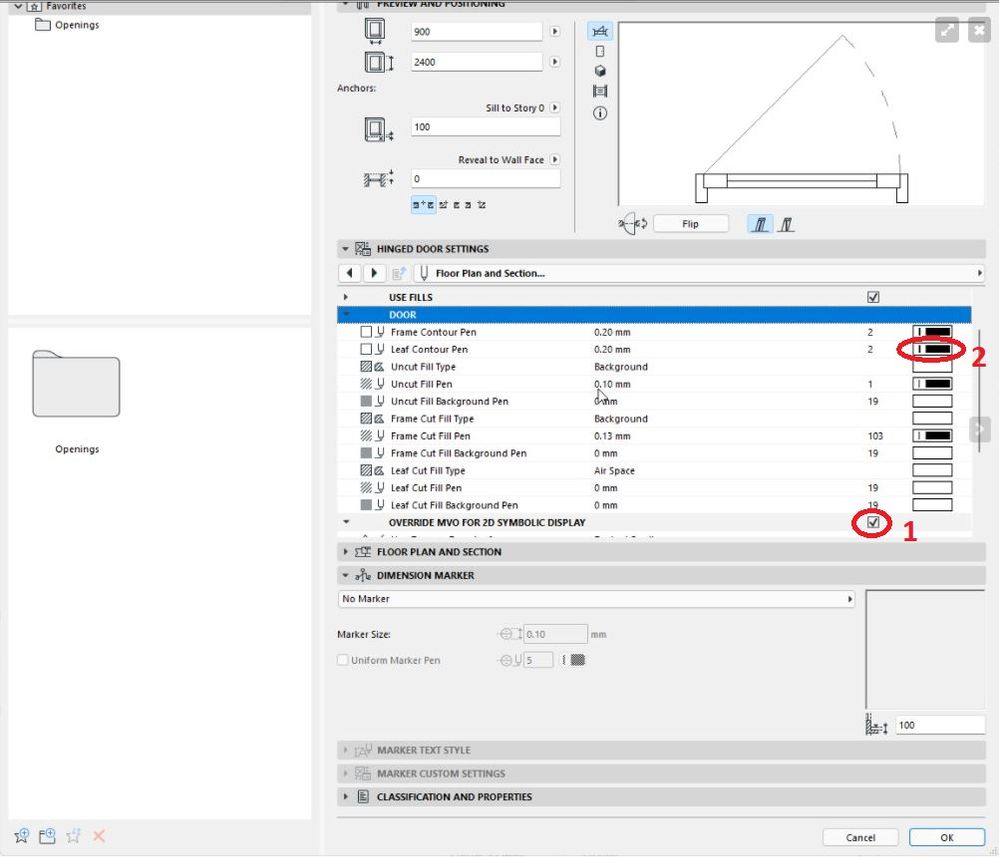

my question was to make lines look like "bold cut lines" parameter is enabled. (which cuts only that is really cut) again, can I do that ? because I can't find that parameter to change that uncut lines. see that image and red rectangle over that line I want to change. I tried all settings there and looks like nothing is influencing it.
See image.
1. Uncheck this.
2. Change this pen value to something less thicker than your frame pen.
Don't worry about how it will show the glazing line cut.
It will still show as slightly thicker than the rest of the leaf that is not cut.
