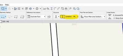

Hey! Whenever the wall tool is active, there is a lot of lagging, I can barely work in the program and the Structure part starts glitching. I tried re-installing ArchiCAD but nothing changed. Do you have any suggestions on how to fix this?
1 Reply 1

@Andreeaa There should be no delay at all, unless there is an issue with your Graphics card / display driver.  What are the specifications of your computer?
