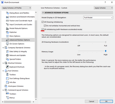

Ok, I've made another video for this strange peculiarity:
https://www.youtube.com/watch?v=MD0xLk1G310
Any ideas as to why the 3d model looks like this in Archicad 26?
Thanks,

Thanks for the speedy reply! The 3d antialiasing wasn't enabled, but it is now. Had to close and reopen the project, but it works a treat! Thanks!
