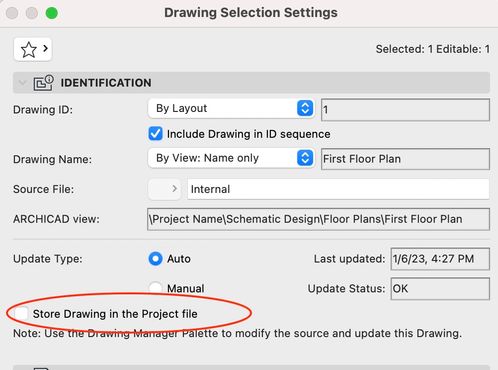

The file size increase could be cached drawings.  Personally, I always keep the checkbox shown below UN-checked to keep the file smaller.  This should have no impact on your CPU usage issue though, but you did mention the file size as bothering you.
