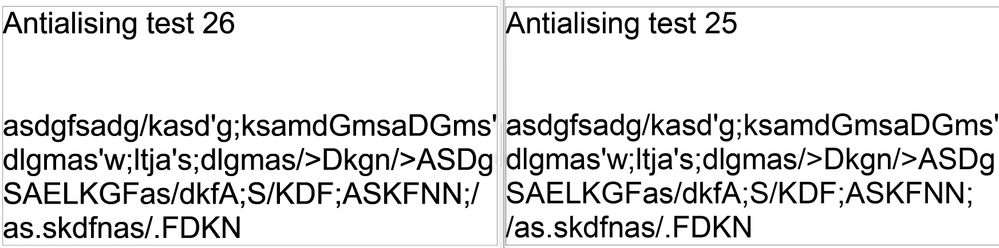

i usually work on a 27" inch 4k display at 150% windows scaling and with 2D antialiasing turned off. Half the lines are thick and blurry.
Scaling at 100% is a bit better but you can still see the the problem.
No problem at all with Archicad 25.

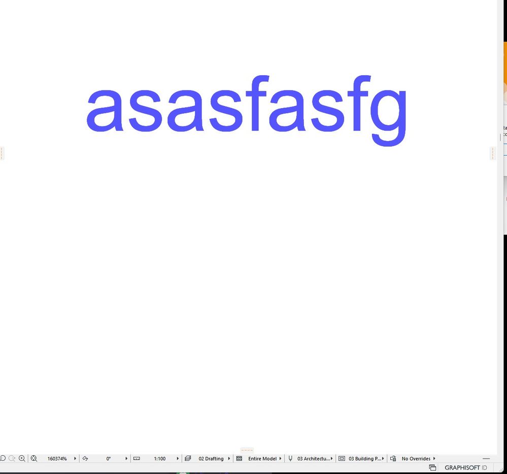

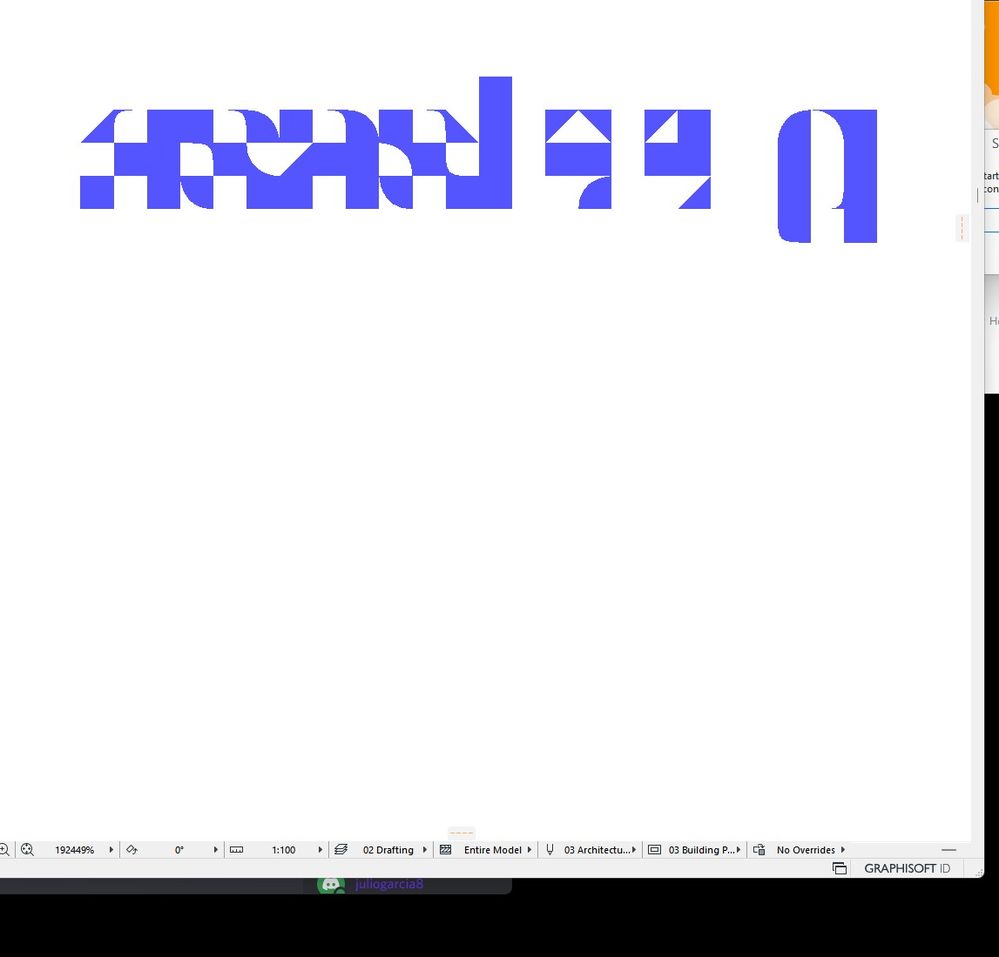

I am also experiencing screen quality problems. Even the input tab window shows the numbers thicker and distorted. When I zoom small text of 2mm (model size) the text gets 100% distorted.
Lines show thicker and not crisp at all. Everything compared to 25.

JUST TO CONFIRM THE FIX AT THE REGISTRY NOTE IN THE POST:
https://community.Graphisoft.com/t5/Document-Visualize-forum/Fonts-displaying-incorrectly-after-movi...
FIXED THE PROBLEM WITH THE LINES. THE LEGACY RENDERING ENGINE WORKS CORRECTLY IN Archicad 26 COMPARED TO THE NEW ONE WHICH FOR SURE NEEDS TO BE FIXED.

The update 4004 for 26 was just released but unfortuanately it does not fix the antialiasing problem.
Text is moving and distorted when zooming. Lines are thicker and sluggish.....
Pitty................
The comparison was made after deleting the registry fix that enabled the legacy rendering.
I will have to renable it.....

It feels like it is fixed. The lines are not thick any more and the fonts are shown correctly.
Install the latest one because there several other things fixed.
