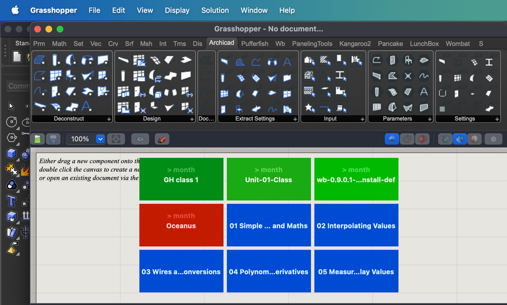

I am using rhino 8, and rhino 7 along with my archicad 27 latest built. I couldn't find a archicad-grasshopper connection to connect my rhino 8 and archicad 27, and when connecting archicad with my rhino 7, archicad menu isn't showing up. the archicad panel is there but the archicad menu on menubar isn't visible. Kindly help me. Thank you
Operating system used: Mac Apple Silicon Apple Silicon Sequoia

Hi Binaf,
Perhaps this article can help:
https://community.graphisoft.com/t5/Parametric-design/Grasshopper-Archicad-28-Live-Connection-can-t-...
AC16 - AC29, Rhino 5-8. Alienware WIN 11
hevi
Ace
The AC27 connector does not support Rhino 8 - you need to upgrade to AC28 for that...
