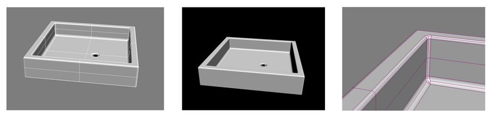

Modelling:
AC is very good for modelling interiors and furniture with middle amount of detail. For very detailed modelling, seen at close distance, the best choice is an Engineering modelling application like SolidWorks or 3dsMax with PowerSolids plug-in.
Rendering:
Ac is not good for interior renderings! For nice results the best choice is ArtLantis. For very high quality renderings use VRay or Maxwell or something like these. VRay seems to be the fastest.

Below is an example of a simple square sink, which will get you in a lot of trouble to model in AC or 3dsMax!
