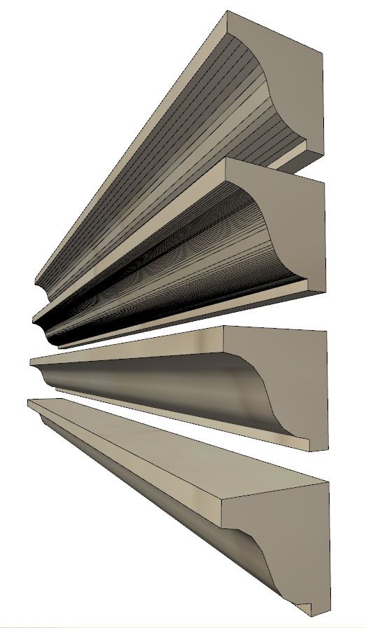

Steven, is that profile larger than normal, or are you using 'linear segments' in the magic wand settings?
If you make a normal sized molding and use 'Best Match', you will see the way that all curves are reduced to straight segments automatically as Steve's image shows. It's only noticeable on smaller profiles.
If you use the 'linear Segments' setting in the magic wand, the profile will be closer to original curve but you will get lots of extra lines in elevs/sections and the 3d window. (See the top two profiles in my image.)
To be honest, I don't know what the answer is. You don't really notice the segments in smaller scale sections (i.e. 1:50) which is generally what you physically model to, but if you need to see the profile in a detail at a larger scale (i.e. 1:5) then you would have to redraw the curves to be smooth. You could even copy and paste the linework from the profile manager to ensure consistency.
Perhaps GS could introduce some sort of scale sensitivity to complex profiles so you wouldn't need to redraw curved objects.
