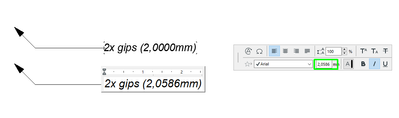

When doing Copy/Paste text from one TEXT/LABEL to another text size changes to weird size.
For example I copied 2,0000mm text from one label and pasted in another and text in another label became 2,0586mm. This is not ok.

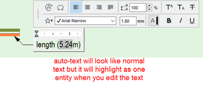

Was it actual text or was it an auto-text value for the length (or similar).
If it was plain text, it will remain as 2,0000 - it won't change.
If it is auto-text, then it will now display the value of the new element you are labelling.

2022-06-02 09:29 AM - edited 2022-06-02 09:29 AM
It is plain text. I was copying from one Text box to another. Using CTRL+C and CTRL+V

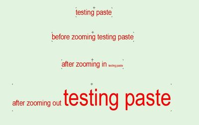

2022-06-02 10:03 AM
Sorry, You are not saying the text is changing values.
You are saying the physical size of the text is changing.
That was a known issue some time ago that I thought was supposed to have been fixed.
Here is just one old post about it ...
If you zoom between copy and paste, it will affect the actual size of the text.
I just checked in 25 and it is not doing this.
Make sure you have the latest update for the version you are using.
It still happens in 22, but that is not longer getting any updates so will not be fixed there.
I haven't tested in 23 or 24.
I would say 24 would be good as that is still being updated, but 23 might not as that may not have had this in an update either.

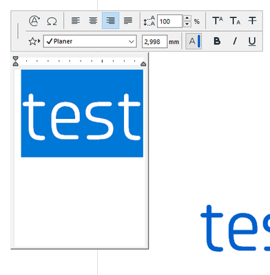

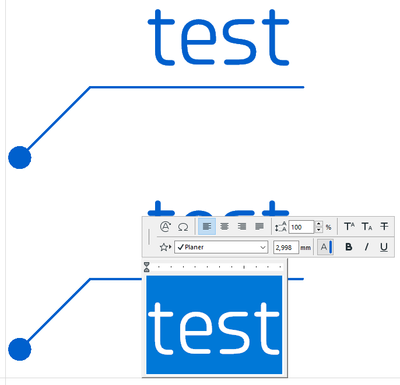

2022-06-02 10:23 AM - edited 2022-06-02 10:25 AM
I checked this in 24. The previous bug Barry mentioned has been solved (almost). The noticeable change in font size has been reduced to something you almost can't notice, but only when zooming in before pasting text. The same behavior is present with labels (original font size 3,000 changes to 2,998 or 2,999):
