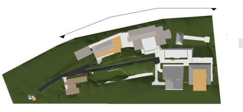

I've been trying to get the section cuts in AC10 to bend. I'm working on a large site with buildings at different orientations and need to be able to cut a site section to display the front elevations of each of the buildings. The difference between orientations is only 10 degrees.
Whilst I have managed now to get sections to bend by fiddling around a bit, I cannot find a way to get the bend to the correct angle. Also the method in which I’ve been using the section line does not yield consistent results.

um... just thought I should post a pic so people can see why a bent section might be useful... though I do agree that it's distorting the truth somewhat
See attached jpeg. (edited in paint )
I don't see why you can't manually do that in ArchiCAD using the method I described before.
If it's just for presentation, then all you need is three separate (but end-to-end) section views as per the straight portions of your view described below, and then generate the three views, delink them (if you wish) and then copy-paste and re-combine them into one new view, marking where each separate view starts and ends with a line.
We do that all the time in our office with angular or obtusely-aligned building facades and elevations.
As has already been pointed out, there is no automated function to do all this yet in ArchiCAD; hopefully in future versions (looks like a simple Macro-script to me; but then, so do Curved profiles in plan, so what do I know).
But then again, you'll be hard pressed to find any BIM or AEC CAD program that can do bent or curved section/elevation views.
