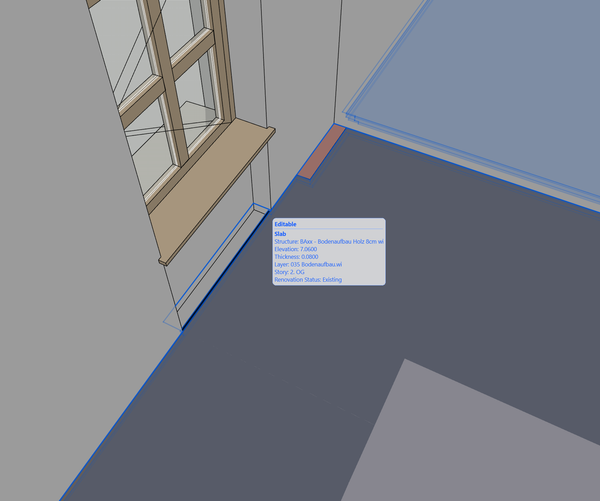

Hello everyone,
I'm having an issue with getting a floor element to display correctly in a cutout I made for a window niche. I'm hoping someone can spot what I'm doing wrong.
My Setup:
  1. I have a Level with basic walls.
  2. I placed a Slab for the main structure of the floor.
  3. I have a Window that includes a niche.
  4. To model the finished floor, I placed a Floor element on top of the structural slab.
The Problem:
The window's niche correctly cuts a hole out of the Wall. However, the Floor element on top of the slap is not following this cutout.
  • In the 3D view, I can see the floor running straight through the niche.

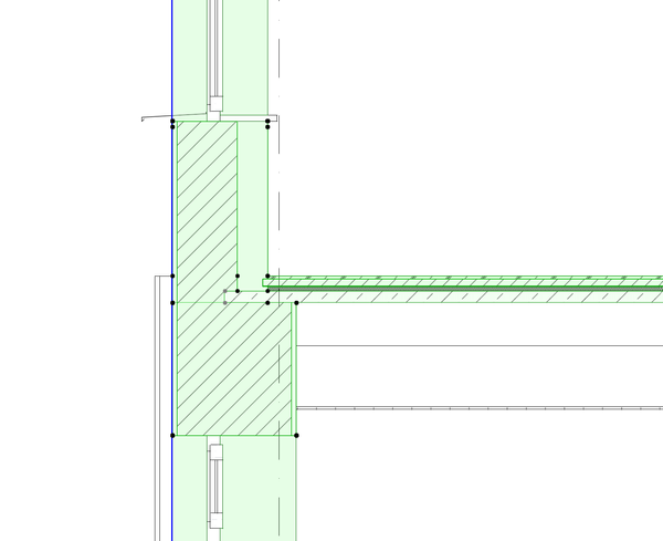

  • In a Section, the same issue occurs; the floor doesn't stop at the niche opening.

  1. I used the Cut Opening tool from the Floor's context menu to manually trace the niche opening from the window.
  2. I confirmed the cutout is there in the Floor Plan.
Despite the cutout being present in the plan view, it is not generating in the 3D model or sections.

Similar issue and possible solution here ... https://community.graphisoft.com/t5/Modeling/Floor-through-niche/m-p/669261
Heftor
Thanks Barry for the tip.
I was experiment and it works as it should when you use the opening instead of the niche, looks like the niche behaves as a wall for the floor.
