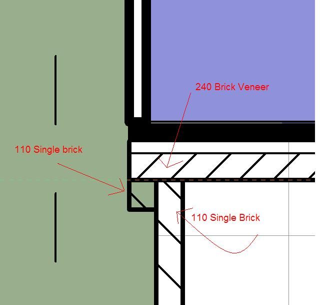

Hi , im having some trouble, i need to join all 3 brick parts without any lines so that i get the right detail, can someone please help. thanks. i'll include a pic of my situation, the detail is for a garage on a brick veneer house.

You've got some problems there, but nothing that can't be solved, either with wall or just simple fake 2d. I'm not sure about how your walls look like, could you turn thick lines off and turn wall beams reference line on?
This could be one solution for you :
looks good how would i go about doing that?
Could anyone with bigger word knowledge in english descibe this?
I have 3 walls, 2 walls with same fills at different thickness and one composite wall.
The important thing is that the wall reference lines connecting too each other.
