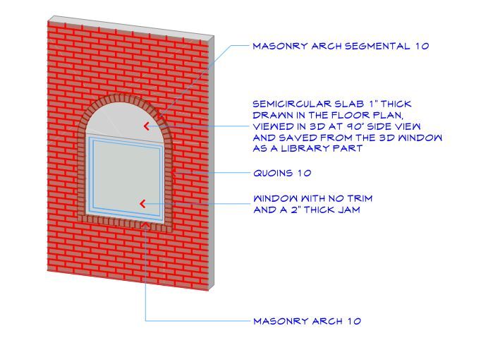

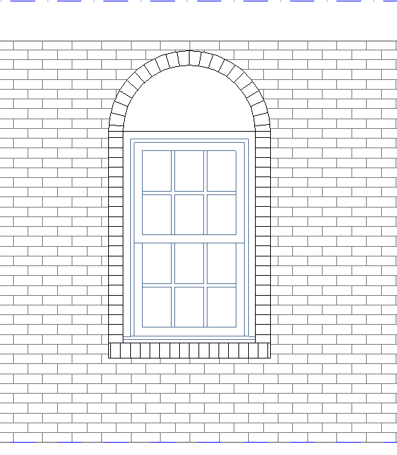

Brian,
This window with brick souround was made with
AC 10 library parts. see attached.
Peter Devlin
