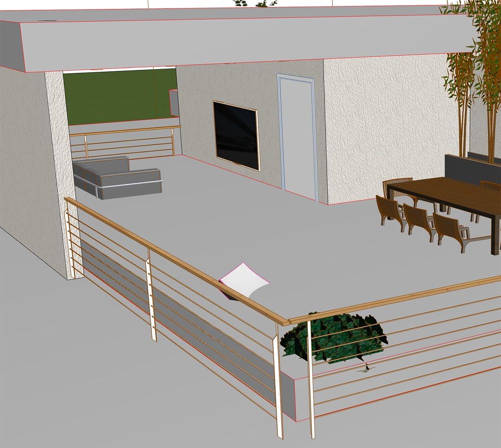

I need to build a raised deck. Please see attache screenshot of the ACAD model and the detail sketch of what the deck will be built like. Can anyone give me a hint on how to best build this?

Part of the answer is what is to be modeled (3D) and what is to be added for documentation (2D). Some users would model almost everything in your detail (except the flashing), I use a more hybrid approach, modeling most elements but adding some 2D detail for construction documents, see attached image. As part of my template I have a number of Composite Slabs for typical construction elements (like the deck shown, also for typical 2x framing construction) so the model reflects the construction.

If that is the route you want to take (not my approach), then:
Decking: 3/4" or 1" thick Slab, depending on decking material
2x Framing: Complex Profile Beams
Flashing: Complex Profile Beam
Hanger: There is a Cadimage Library here on the bimcomponents.com web site that has some joist hangers, or a simpler one could be made from the Morph Tool
Exterior Wall: some users have made Complex Profile Walls with the sill and top plates as part of the wall
