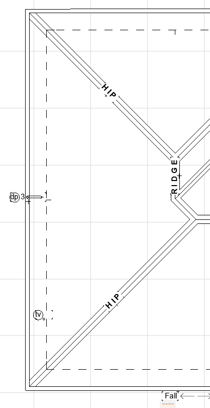

I have uesd a cadimage roof covering and have set it to be tiles. on my roof plan i have the roof coverings layer on and it shows the roof but shows the cladding as blank. On my elevations it shows the roof cladding as being tiles and if i show my roof coverings layer on the floor plan it shows up with the correct cladding. Im wondering if its a model view options problem?
3 Replies 3
In the coverings' Plan View settings there are options for what to display on home storey as well as stories above and below...
Thankyou!! The Cladding box was unticked
