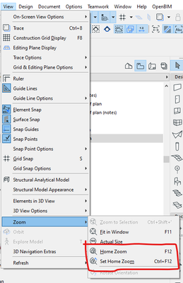

you can specify where you want to immediately zoom to in a Saved View or override it.
when you first Save a view, the blue box above determines your zoom.
if for some reason you want to override whatever zoom you have in a saved view, check the box in the red circle. the view will open in the last position it was previously left.
if you want to save zooms on-the-fly but keep the Saved View settings un-touched, i would suggest playing with Home Zoom.
this can be useful when, for example, you have to move to different parts of a view (plans / sections / elevations / internals) but also have to keep coming to a base zoom -- this is the Home Zoom.
I have macros set on my vertical mouse that can toggle between forward / background as well as Set Home Zoom & Go To Home Zoom on the fly.
