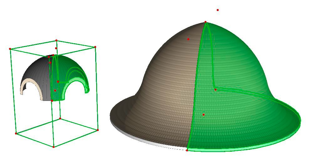

Most of this is easy with OBJECTiVE. You can create the domes by drawing a cross-section through the dome and creating a swept profile object with OBJECTiVE's profiling tools. Refer to some other examples I've posted recently.
OBJECTiVE's Split tool will also help you to cut portions of the dome away, rendering it correctly in 2D and 3D. You can also create, bend, rotate, and cut section profiles to create arches and other details. Another student recently sent a picture of a model they completed with OBJECTiVE with some similar detailing (attached).
Note that OBJECTiVE is free for use with the educational version of ArchiCAD. Download here.
