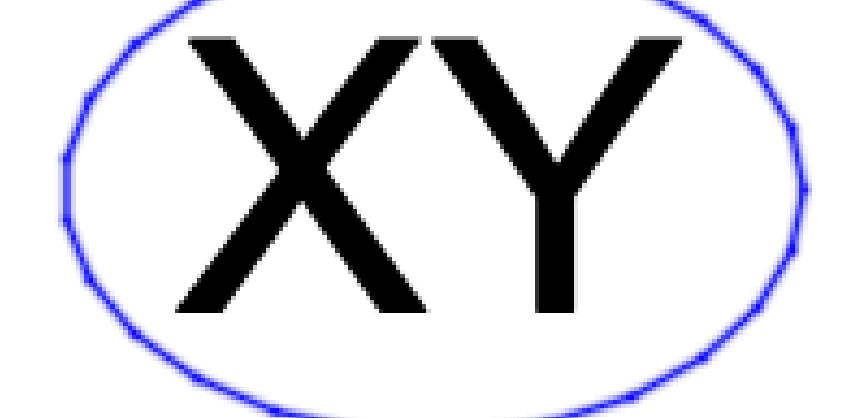

I work a lot in Archicad with circles, arches, and curves whether for interiors or product designs and I noticed that no matter how much I zoom, select thickness of the pen, or anything, the arches, curves and circles are never looking smooth, but quite pixeled , like when I am doing circular object, it shows the connections between the lines to make that circle, creating pixelled, windows 1990 look. I would prefer more elevated, modern smooth lines instead 😄
Please don't tell me this is normal? Is there some setting around this? I believe, that I was working in archicad on similar project in 2021 and I didn't observe any issues. Print screen attached

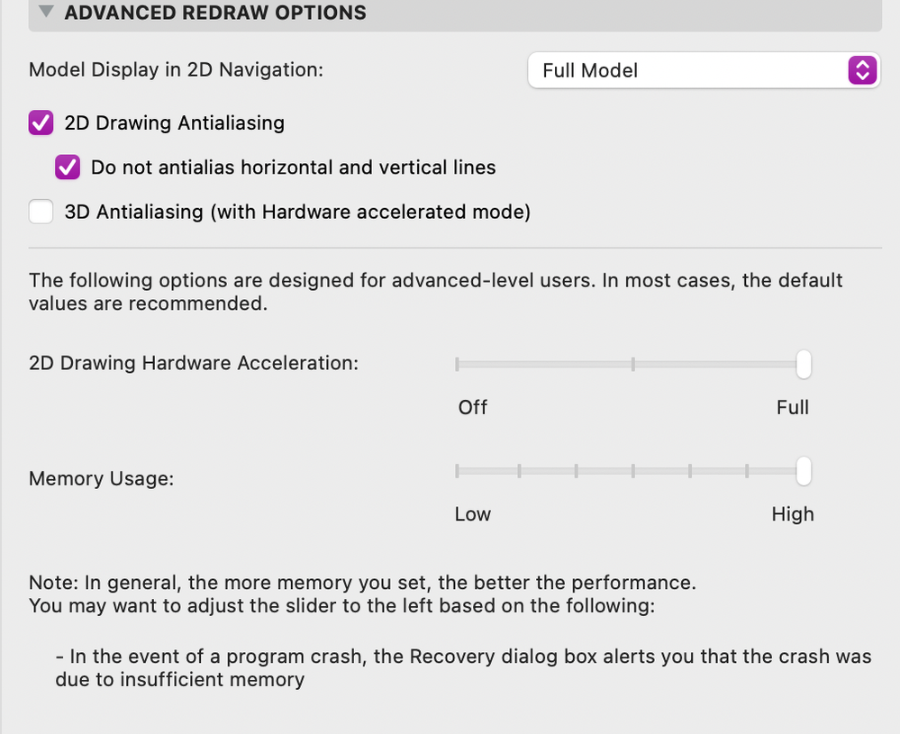

Work Environment => Advanced Redraw Options => 2D Drawing Antialiasing

Hi! So I tried it but it seems I had it "on". Please see printscreen, does it look right to you ? Thank you so much

Yep, tried to play with this setting too but same crooked looking round shapes. I woud swear that 2-3 yo ago I had no issues

In the image with the oval, it looks like it has been potentially generated in the code that created that "Label" with approximating nodes and lines?
Does the drawing possibly originate from Sketchup or some other software?
If it is sourced / created in AC and you are seeing the same problem with other elements then you really need to declare the actual version of AC e.g. AC26 INT v5002 Intel / Silicon,  Windows / Mac etc and some info on your hardware e.g Graphics card and screen resolution if you need to resolve this.
