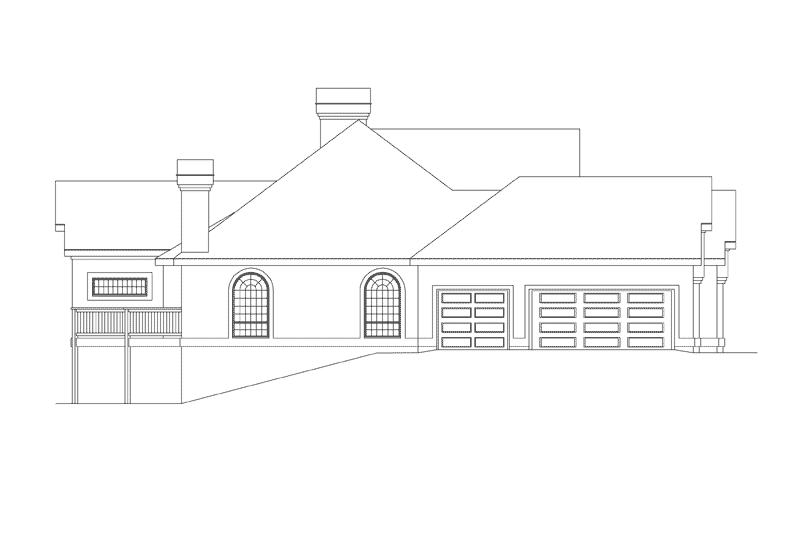

I need to create a window that uses a set of double hung windows with an arched window above. I cannot seem to find this kind of window and do not know how to make one. I am new to this program. Can I combine two different styles of windows to make one new type? I am attaching a pic of what I am looking for.

This should be possible combining Double Hung and Half Round units, utilizing the Ganging parameter. They will remain separate units.

Thank you for the advice on the signature. I will study up on ganging and see if I can understand how it works. I want it to appear as one unit. I am also searching for other free sites where I might find something similar.
