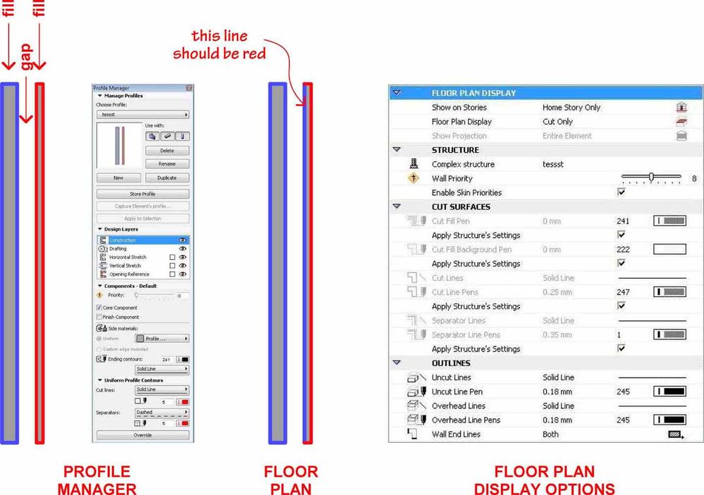

Hello everybody,
I am back with the following problem: I made a complex profile using 2 simple fills (with a gap between them) and I assigned it to a wall. After drawing the wall, I get the result in floor plan as seen in the attachment (one line is not as it should be). Has anyone else encountered this behavior? Is there some setting I might have forgotten about?

Seems like a glitch. Never seen it before today, but I can reproduce it. The only way I could figure out to get around it is to add a fill in the middle (airspace fill?). If you set the 'ending contours' of the middle fill to white, then in plan you'll get what you're looking for. Don't know if that will create another problem in section. But in section you'll probably want a fill there anyways. Otherwise you'll see through the middle of the wall to whatever garbage is beyond.

This bug had been reported here some time in the last few years, perhaps AC 11 or 12 era. I remember a bit of discussion, and reproducing it myself as it seemed pretty surprising. I'm surprised it has not been fixed yet.

Thank you Jared and Karl for your replies. I was kinda hoping that it wasn't a bug and there was something I missed.
Jared, actually yes - I want that gap to show in 3D. I guess I'll try making that using 2 walls with a gap between them (which will complicate things when dealing with windows).

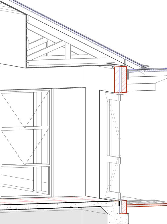

Thank you for your replies and suggestions. I apologize for not giving more details about the situation I was dealing with. I attached an image showing what I wanted to achieve. In the end, I made a complex profile and as Jared suggested, I added another fill in the middle. Finally, I played with "Partial Display Settings" to achieve what i wanted.
Yes Rod, you were right: for the example I showed before, that thing could have easily been achieved with composites. Unfortunately, that was only a simplified example.
