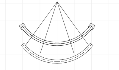

Wouldn't You divide the much longer distance in Your curve into smaller peices, so that Your geomety of Your first picture is not so much distorted when bent?
Archicad has no direct command or built-in-help for something like this.
But its definitly possible to make nearly every form with extra parts - also Your wish - but not bending existing models.
The profile cuts the wall with an SEO-command. The profile is a railing-profile with just a single handrail with this profile.
Just one of the possibilities..
