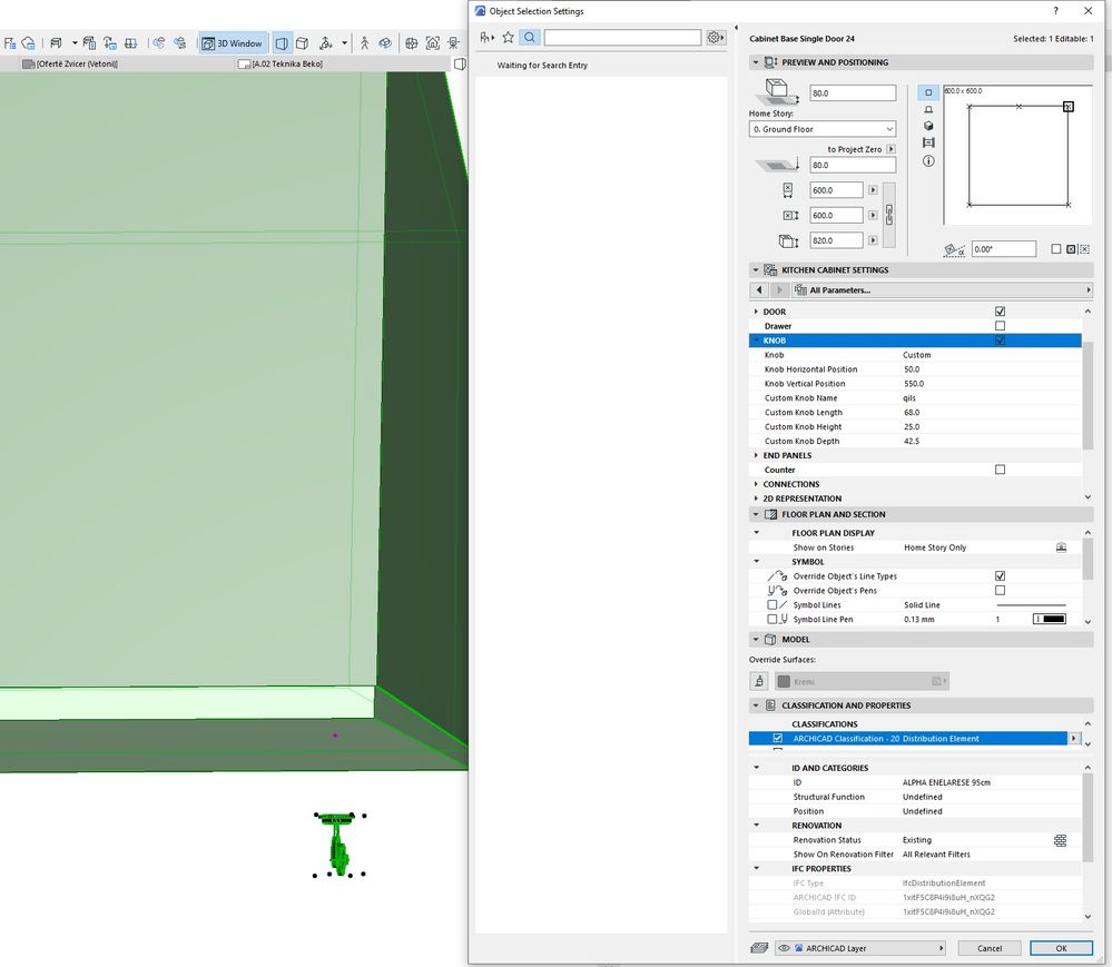

I am working with custom knobs in Archicad and the knob is detached from the cabinet door (floating).
It is the right size and everything, I just can't seem to figure it out how to attach the knob to the cabinet door (I am using a Locker Key model as a knob).  I have attached two screenshots.
Thanks!
2 REPLIES 2
When you create your custom door knob, make sure you do it at the project origin (0,0) and at a base height of zero as well.
If you model it at a height above zero, that is probably why it is floating away from your cabinet door.
