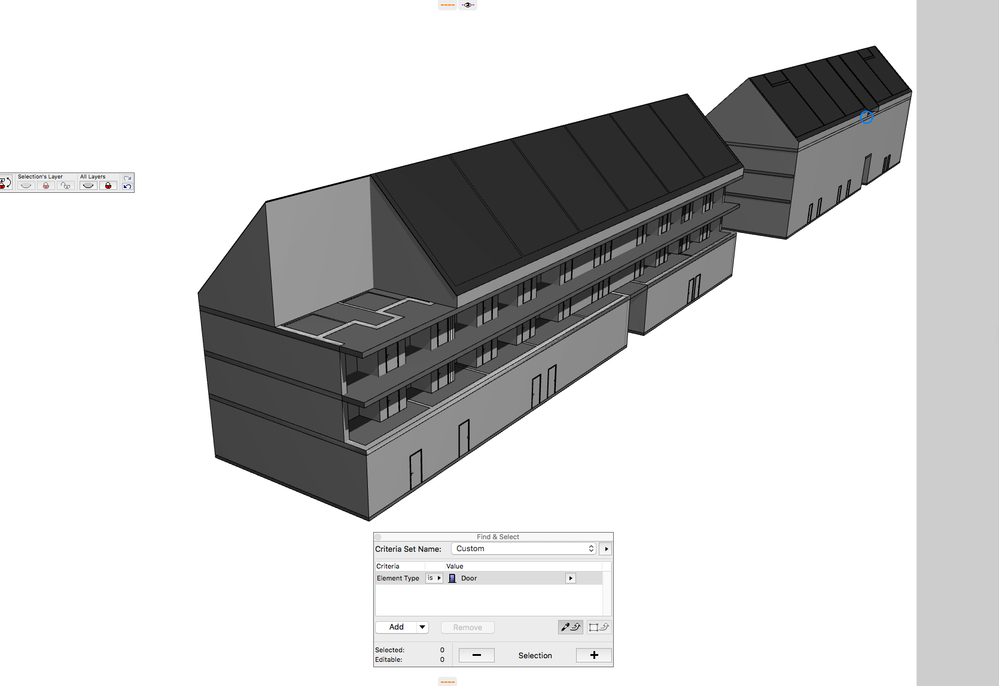

I have a file where the walls are visible through floor slabs and roofs which they are intersecting. The walls on the top floor are cut by the roof, the other ones have the top level on the same level as the roof. Of course I can make the walls shorter, but it shouldn't be necessary as far as I know - and it doesn't solve the problem with the roof.
The walls are on a layer which have a lower intersection number, and the walls have a building material with a lower intersection priority than that of the roof/slabs, so what am I missing here?

@DangCad In order for the Building Material PBC to be effective your Layer Intersection Number needs to be the same for the intersecting elements.
