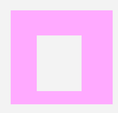

As a test I deconstructed a fill with a hole in it, and used the polygon to generate the mesh:
The used fill:

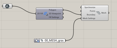

The script:

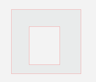

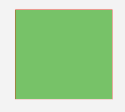

The result:

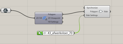

When generating floor slabs, the input is polygon (not boundary) allowing a hole:
