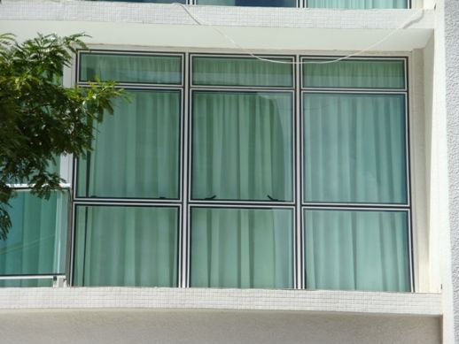

Creating this kind of curtain wall and window
How can I create this kind of structure in a curtain wall and in a window ??

yes Ralph... that's it... but the middle white strip is thinner...
how did you do that??
is it possible to use it in a curtain wall???
