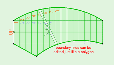

It is hard to say exactly without seeing the stair you want to make.
But remember, once you have the base structure of the stair modelled (tread length, riser height, landing positions).
Then yon can select the boundary of the stair (not the baseline) and adjust it to any shape you want.
You will see 2 boundary lines that you can edit - these are different to the one baseline.

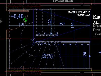

palmfikret
how to draw this figurehow to draw this figure ladder

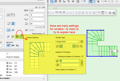

When you say 'ladder' you mean 'stair'.
As you place the stair, you can use the pet palette to switch from flight, winder to landing, etc.
Treads 1-6 will be place as a 'flight'.
Then switch to 'winder' for 7-13.
13-14 is possible a landing.
14-17 is back to 'flight'.
I have never done a stair like this with angled risers/treads on the straight part of the flight.
So I am not sure exactly how it works, and unfortunately I don't have time to experiment at the moment.
It is possible to get those angled tread - I am just not sure how as I would never build a stir like this.
