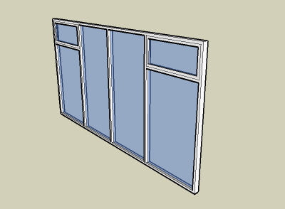

The window that I am trying to make is quite simple. But not when I try it in AC.
The thing that I can not change in the library is that I want more posts in the window. I only can find window with three posts in the library so when I want to make big window I can not add more posts or opening as I would like, only use the windows that are in the library.
Here is the window that I want to make in AC.

Picture helps greatly.
The attached image shows two standard windows 'ganged' (or 'mulled') together to achieve more or less the result you want. (Trim and frame sizes not adjusted to match your picture.)
What I did was to place one window with the ganging checkboxes as shown, and then mirrored a copy onto itself.
I'm not sure if the INT library that you have has the windows with the options shown for ganging, since these are in the US library. Hopefully, it does. 😉

The window you illustrate can be built in just a few minutes without any programming using beams or walls for the mullions and a slab for the glass. See section 2.5 starting on page 22 here:
http://tr.graphisoftus.com/downloads/DL's%20for%20GraphisoftUS/Introduction%20to%20Object%20Making/I...
(You will have to copy/paste/edit the long URL above into your browser. Download the whole file.)
For non-rectangularly shaped windows (or doors), you simply need to include another slab with the ID field set to 'wallhole' (no quotes) - and this slab will not be visible in the result, but rather will determine the shape of the hole cut in the wall when the window (or door) is placed.
No programming of GDL at all. Not parametric, either of course.
