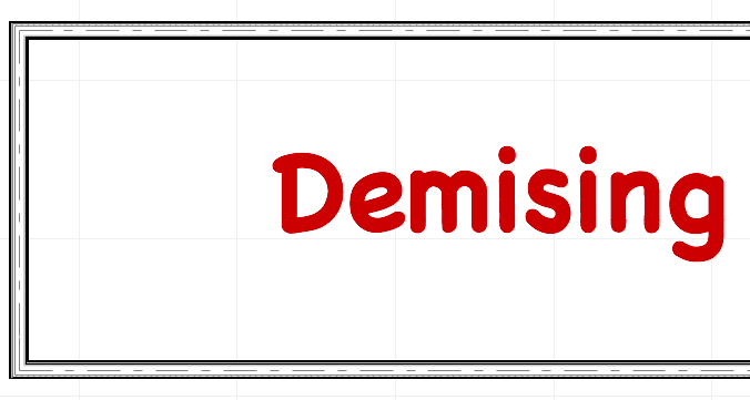

Dashed line in middle of Composite wall
I created a dashed wall at centerline of Composite Wall to represent a demising wall but had to divide the center value into 2 equal halves.
Have a better method ?
Always open to hear your ideas

Michael
Plan View Graphic of Demising Wall

That's the best way to put the centerline down the middle of the core, but you don't need to enter 0 thickness skins to get the other lines. You can just set the skin lines.
Cheers,
Link.
