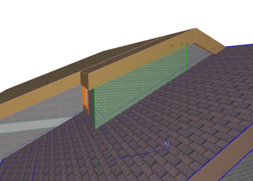

i'm working on my project, and i'm wondering if there is a way to paint selected wall above the roof (see attachment) in different color(texture) as the wall below. Wall above the roof should be same color(texture) as it is now, and wall below the roof should be different color.

There is no simple way to do this, the easiest solution is to have two walls, one below the roof and another above. There are ways using SEO where the target (wall) picks up the Surface (Material) of the operator, but this is a more complex solution.

Thank you David for your quick answer. I managed to create what i wanted with your suggestion. I added signature to my profile as well. Thank you again!
