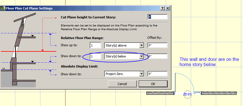

I'm wondering if there is any way to display doors on the wall's home story when the wall starts more than the height of the door below the home story?
1 Reply 1
Would having a "view" that has it's Floor Plan Cut Plane set to include story below work for you?
