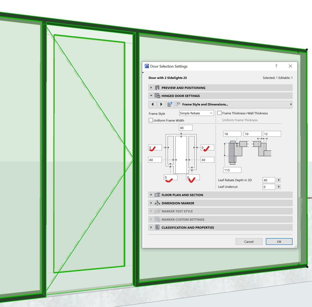

Is there a way to make window frameless side by side with door with standart frame? I did not find the settings in the door selection settings as shown.
Thx in advance.

A value of zero does not always work because in the script the object is then trying to draw something that has no size creating errors.
It depends how the object is scripted.
The sill looks like if you set it to zero, it just uses the default frame thickness.
Strange though that it lets you set the side frame to zero.
The top frame is all one part over the door and the window.
So you won't be able to control that separately.
The object is just not written to do what you want.
You could have a look at 3rd party doors and windows.
They may (or may not) be able to do this sort of thing, but you can expect to pay for the privilege.

Can we set the window to be "frameless" without remove the door frame. see the image, i want to remove all window frames in the red area.
I want to keep the door as they are (easier to make the door schedule), so i do not want to make the model.
If i build with curtain, the wall hole will not flexible. this door with window are study so they will move to some where. Or is there a way to make curtain automatically cut the wall?

After all, on the other window, we want the glass level are about 1000mm from the finish floor (see attached image). The image shown that the bottom frame of window set to 0 (zero), but in the 3d model the window still have frame, not like in the side of window.
If the object will not allow you to have zero width frames then just add a door to a thin glass wall.
If the zero width frame does not work, what happens if you just make it a very small number like 1 or 0.1?

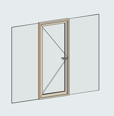

And another way? Put a normal Window aside the single-door? In the schedule-List,  it would be an extra window, not a combination, but would that matter?
like this:
This value absolutely work. But why not work for 0. And how about the top frame? any suggestion?
