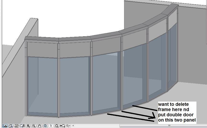

Double door on curtain wall with deleting one mullion !!
Hi everyone i want to delete one mullion frame and that will result in joining two panels so here i will put double door.
How i can make this happen
setting it into invisible will not solving my problem that i have two panels
taking also into consideration what if i have in future irregular division of frames
thanks

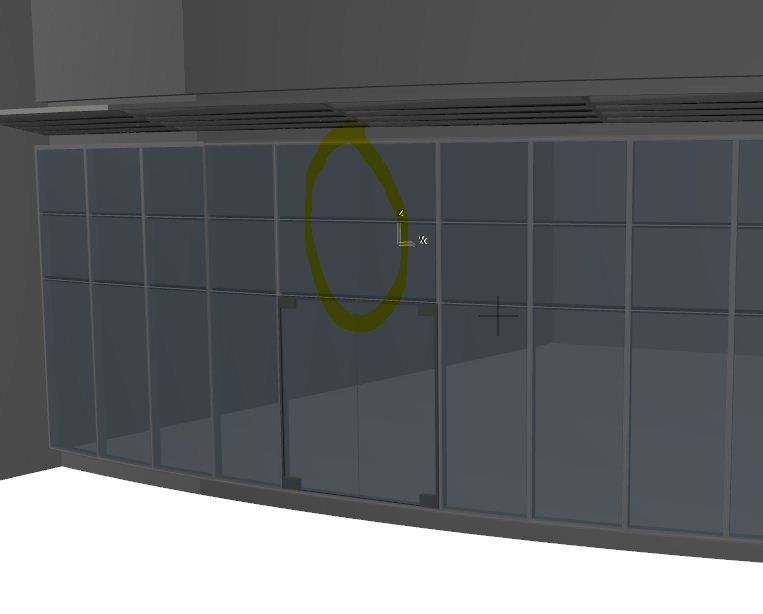

Sorry to resurrect an old topic, but I am having problem with this setting. As per the attached image, I would like to have the panels above the double door to have mullions as with the adjacent panels. I cannot use the double door as you have instructed if they are of different planes. I tried using 2 doors, but the problem is that I cannot mirror the doors, and the mullion between them cannot be deleted. Please help. Thanks.
David Maudlin
Rockstar
Try selecting one of the adjacent vertical mullions that are above the door and Dragging a Copy.

Thanks David, that was spot on.
