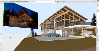

Below is a picture/texture on a wall that I was using for a modeling reference.

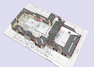

A properly scaled image/texture of a floor plan can be put on a slab, and then walls can be modeled to set right on it.  Or the building model displayed in a cut-away and setting on the image/texture floor plan for some interesting views of a pseudo-3D floor plan.
Not a great example but you get the idea I am sure.
With properly scaled image on the slab, you could just model the walls in the 3D window right on the slab that has the Image Fill of the floor plan on it for 2D stuff, and the same image as a Texture for use with the 3D window.

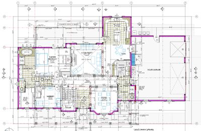

The way you do this is to take a screen shot of the floor plan, a little larger will not hurt.
Then paste the image into a Plan View.
Draw some lines a dimensiond distance apart for some dimension shown on the floor plan
Resize the image so the dimensions show match the lines drawn and dimensioned the same
Now the important part --  place a hot spot on each corner of the entire resized image
Dimension those hot spots Horizontal and Virtical
Now when you create an Image Fill give it those dimensions of the resized image fill.
Draw a slab from corner to corner to match the size of that Image Fill.
In the 3D window you can now apply the Surface as a Texture that you made from the Resized Image.
Now it should look correct in both 2D and 3D view.
Below is a view of a slab with the Image Fill of a floor plan screenshot.

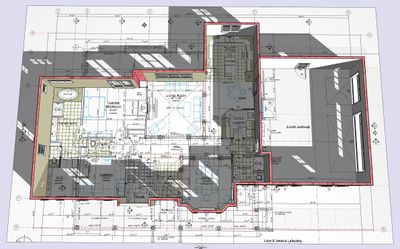

Below is another 3D view of the slab with some walls traced per the scaled texture on the slab.
This is a crude example but shows how it can be done.
Where I have more use for something like this than floor plans is with photographs of some ornament/object I need to model. I can put lots of images on a wall that is always visible to me in 3D view.

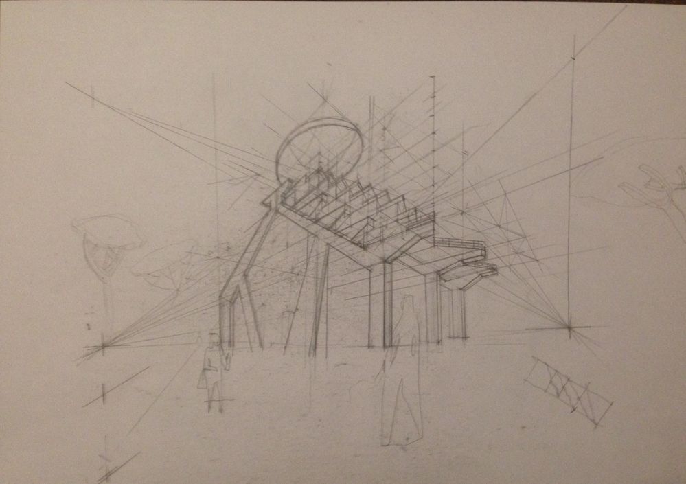

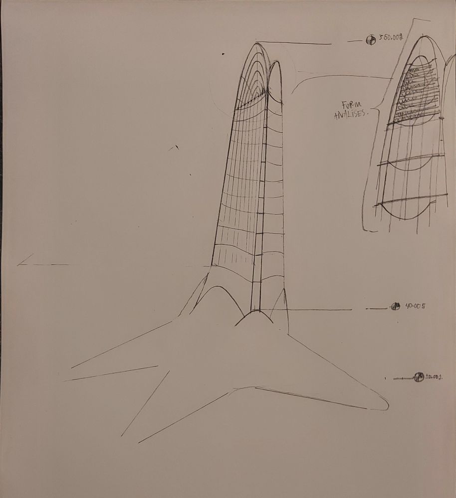

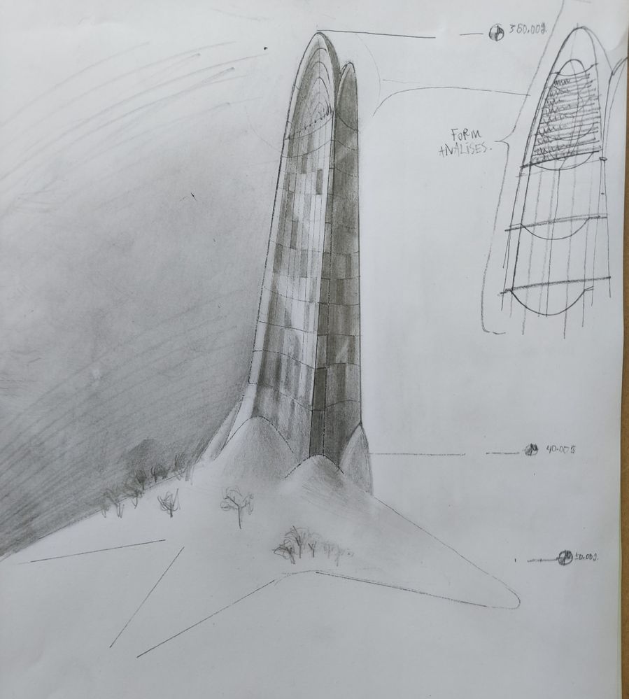

    I'm using Archicad for quite some time but i never thought about this workflow so basically i have no problems sketching some free perspectives and i wanna learn how to transfer them or correct some lens in photoshop before starting modeling, so down below is attached sketches of mine and i wanna to model it in 3d, any ideas and suggestions will be crucial for me in future workflow. P.S. i've came across to some camera options and camera align tools which I've always skipped, so main idea is are they accurate and helpfull wen constructing from photo or a hand drawn image or it's better to experiment just with what you've suggested.
also feel free to critic my perspective sketches if u thinks something is off or just suggest how to fix them for better modeling scenarios.

in the first picture, I just placed an image on a wall so I could use it as a visual reference in the 3D window.
In the other pictures,  the image/screenshot is resized to scale and has dimensions that make it easy to trace using walls.  It can be done precisely by typing in the distance of each wall or by tracing manually and adjusting later.  This is now you can do this in the 3D widow if you like, vs in 2D Plan view if you want to do it that way sometimes.
As far as how to model what you are showing in your sketches -  because they are drawn in perspective they will not be useful for much more than a visual aid.  However, you can certainly model whats in those sketches with ArchiCAD.  The only complexity I see is the concavity, but this can be done easy enough with Morphs and some SEO.
Steve Jepson
about modeling the structure in your sketch.  The first question is what is it going to be?  Is it a building, a monument, or just an exploration of a concept....  are you making an initial model for the sake of exploring the potential structural systems and building materials to make it with...  all kinds of things determine how you might model what's in your sketch with ArchiCAD.
When something like your sketch is modeled with ArchiCAD, it usually involves a bit of trial and error with what elements and/or objects will be used to establish the final geometry.
I have only a about 1/2 hr now to do that.  I will post later what I used to model it.
