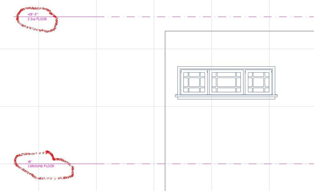

Elevation Height Lines
How do I get the story height lines to print on my elevation layouts? They are visible in my saved views but they don't print.
1 Reply 1
Mats_Knutsson
Mentor
You can choose hide, see only and see and print in the elevation settings.
