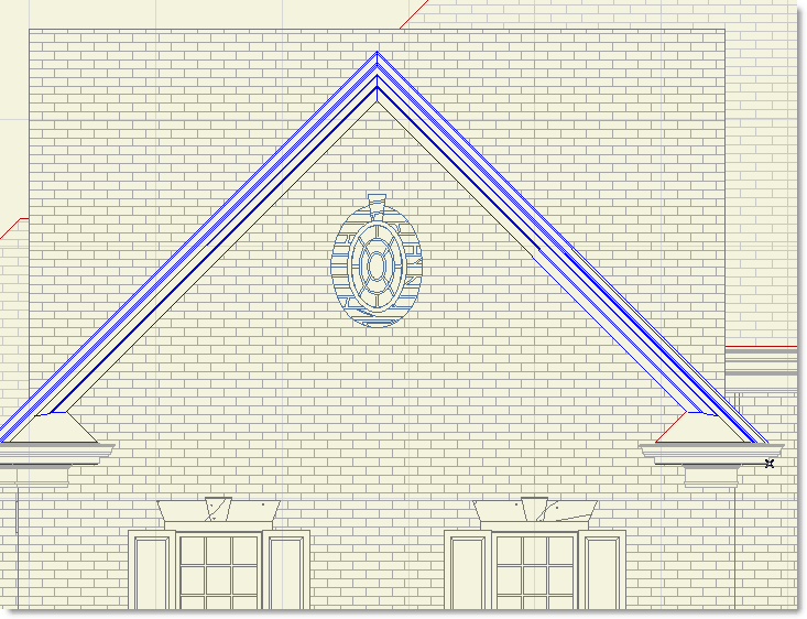

The garage required 2 walls because there is no second floor but there is a window up there.. I don't know why the separation line remains.. they are the same wall copied up... I wish I could use one wall and tell the window not to show below it's floor's elevation. This is a VERY common condition so I must find a smooth way to deal with it.
The door on the right is the same as the one on the left of the same wall..
The crown and frieze meet the roof return but no intersection lines?
I know for the pros here these are minor.. Thanks for any input.

Rashid wrote:You certainly remember how to "draft" don't you... ArchiCAD saves a "million" hours a year, but sometimes, you have to draw. Try unlinking the drawing....or copying the section to 2D. You then have complete control over your output...
My reseller has not been able to help with these...

1. The two walls are slightly out of alignment, (this may be so slight it is not noticeable until you are at 6000% enlargement in plan)
2. The textures on your walls are not aligned, but really close. You need to go to the 3D window (using internal rendering engine with Vectorial 3D hatching set to on) then select the element(s) in 3D and from the Edit menu choose Align 3D texture>Set Origin then chose a point on the model for the texture to start. This seems to be more noticeable with brick patterns.

Rashid wrote:Have you tried S.E.O.ing the crown and frieze (use subtraction..I think) that should get the intersecting line to appear.

Thanks.. I will keep that in mind from now on.. Your thoughts on why SEO or Trim to Roof makes the line between upper and lower walls visible?? Here it is with the upper wall at full height.. You have seen it once trimmed.. Minor really but...

Oh, man... I don't know. I will say.. I never use trim to roof any more... just because... if I change the elevation of the roof.... the wall "trim" moves with the roof.
Try this and see if it helps...
Change the elevation of the bottom of the upper wall (different than what is is now), then change the top of the lower wall to the same elevatiion. Is the line still there?
