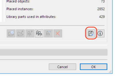

After exporting the files (objects) from the embedded library into the Archicad library, in new folders, I can't find the objects or the folders in the Archicad OR the embedded libraries. I must have made a wrong turn somewhere. One thing that confused me was when you talked about the outdated floppy disk icon-not sure where to find it or what it does?
DGSketcher
Legend
You will need to create a folder on your hard drive external to AC. You will need to ADD this folder location to your loaded libraries once exporting is complete. The export icon is shown in the lower right of the attached image taken from the Library Manager dialog/window. Select the files you want to export then click the icon. You then need to navigate to the folder you created. Save the files and then add the folder to your library.
