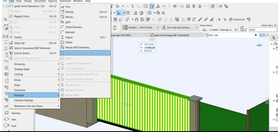

  •  hello does anyone know why I can't access the morphing object disunion function (explode in stream view) even after selecting the object concerned, there it's a portal I want to separate the me structure tallik and the wooden cladding

Now, morphs can not be exploded in 3D - that is why the command is not available.
You can do it in 2D, but you will just get lines and polylines.
It appears that your suspend groups is not active.
Turn this on and you may be able to select separate parts of your morph.
If it is still one morph, then you will have to use the split command to break it up.
