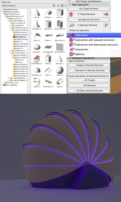

Try using the basic shapes in combination with your own materials and solid element operations. (see images)
I find that by using this combination of tools along with lateral thinking and some of your own materials, there is virtually nothing you cannot make using ArchiCAD.
Basic Instructions on how to use this are in the User Manual. I have attached an example of some of the work some students have done in this way.
