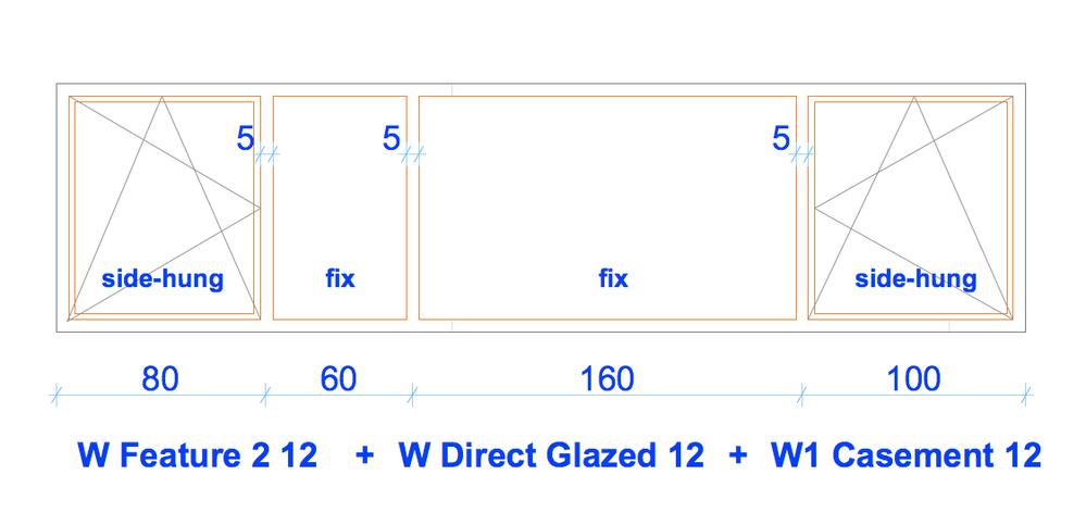

This might also help as well as an example
How to model this one?
This is how the window should be interpreted by the constructor .
Different aspect isn't it?
I still need a lot of 2D enhancements although the solution could be this way simply.

Someone is interested to participate in a new topic?
A depository of plain 2D window representations that can't be achieved with ArchiCAD 12 in daily practice (unless work-arounds...).
GS can deside then to have adjustements in existing library parts or to add extra window types.

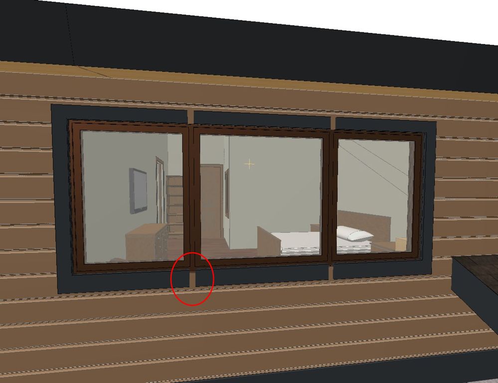

Besides this ganging problem, does anybody know how to get rid of this gap between the sill and bottom trim on a window. I looked everywhere in the settings and tried everything but I can't get rid of it. Thank you.

Has there been any resolution to this? I would guess that the 2d aspect may have been fixed but it seems the casing is still not working properly. I still have a gap between trims when I gang windows together. Anyone else have an idea why this is happening?
I asked around and there doesn't seem to be a solution. Just aggravates me that something that worked like a charm reversed itself in an upgrade.
Let me know if you find a solution. Only thing I know to do is fake it. Make a layer and have it hidden on all but 3D and basically overwrite the trim that isn't working. Make it like 1/16th thicker so it will cover it. I hate to tell someone to fake it but that is about the only thing I can think of.
