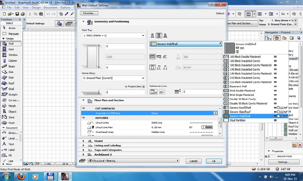

hy, can someone tell me why in my Generic wall/shell i can't see all the wall composite types. i attached 2 image , in first there are just a few walls composite and in the second is full

You appear to be showing images from two different files.
Each file has its own composites stored in the file - they aren't necessarily the same.
You can use the Attribute Manager to append or overwrite the attributes from one file to another.
Overwrite attributes if you want the files to be consistent with each other (so if you copy and paste from one file to the other the wall type does not change).
Append if you are always going to use the file as an isolated file (i.e. no copy & paste or hotlinks to/from other files).
