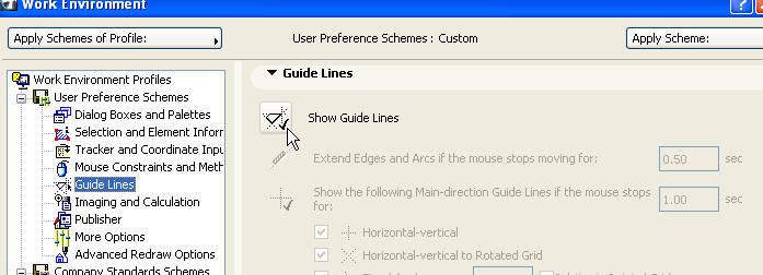

Danielle,
It seems like you had just turned your guide lines off.
When they are off all their settings in the work environment are greyed out.
Turn it back on via the menu of toolbar button if you have one set up.
Or go into the work Environment and turn them on there.
It isn't very clear that the icon in the top left is actually a button untill you drag your mouse over it.
